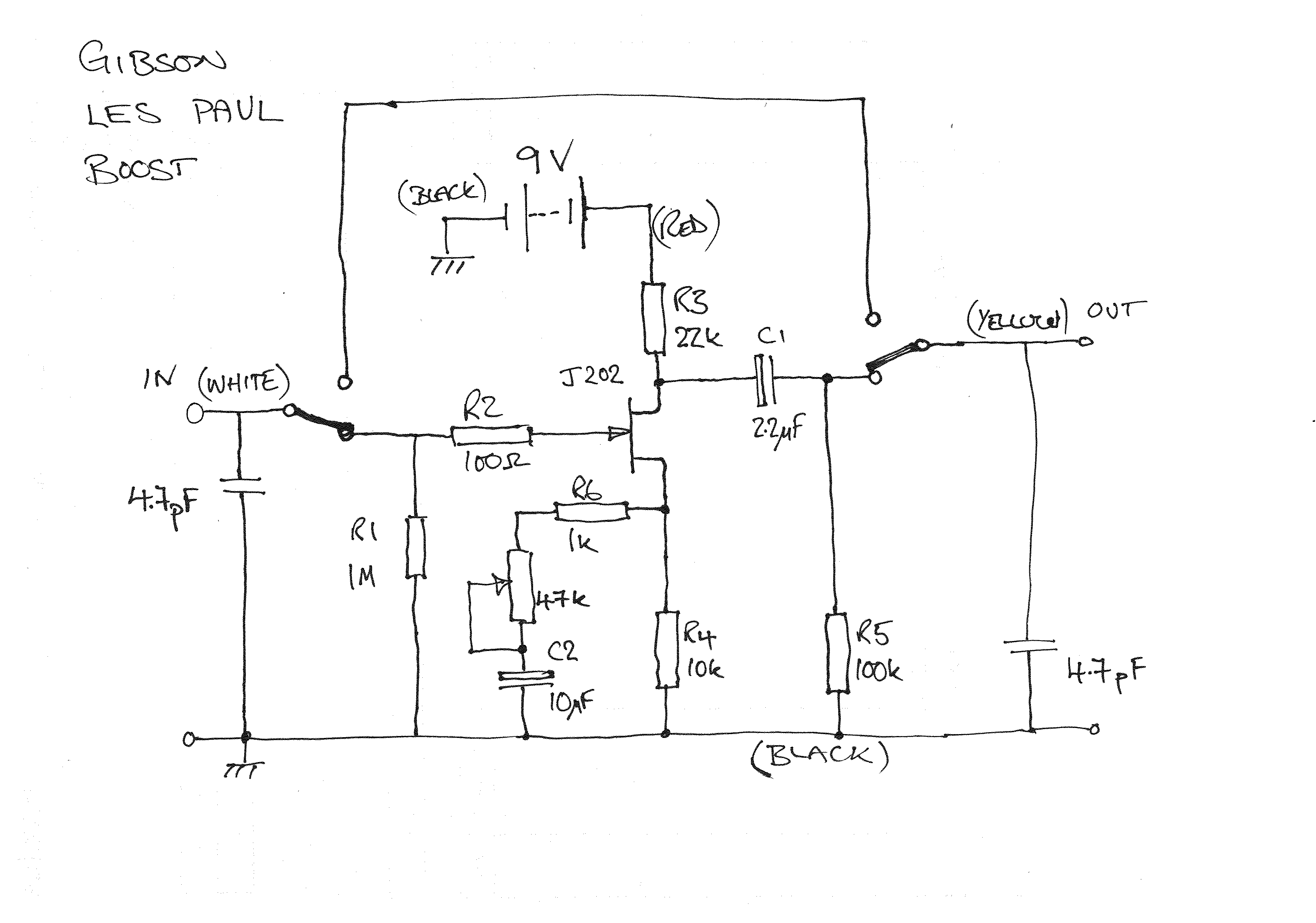

The 47k trimmer sets the boost gain. The 4.7pF caps are an educated guess. I think they are just there to avoid RF interference. It was odd but the source terminal of the J202 FET was connected to the 22k load resistor R3. I guess they are interchangeable.
CCI08022018.png [63.27 KiB]
